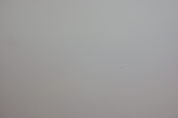

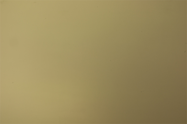

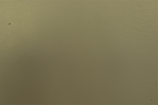

Day 1 - I used only the blower. Photo 1 is how the sensor was before I ever cleaned it and photo 2 is after many blasts from my new "Hepa Jet II" blower.
The large piece moved but that is about it with this method. Also I realise now that all it does is move the dust somewhere else for it to come back later.

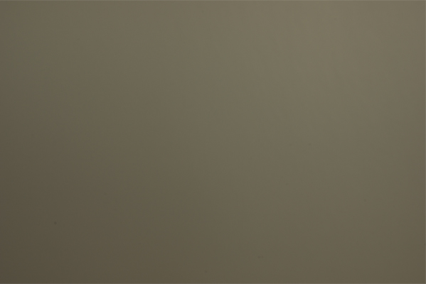

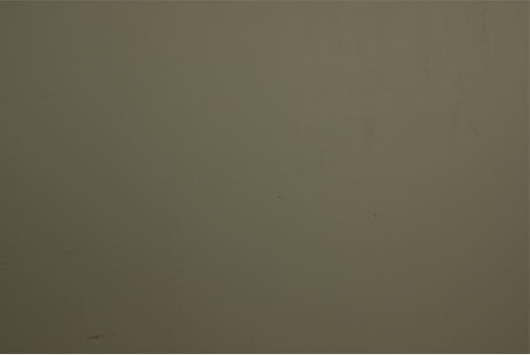

Day 2 - I used the blower again and tried using the "Dust Aid Platinum" to get rid of the stubborn pieces.
This only smudged the spots and added residue. I then tried using the "Sensor Cleaning Swabs", only without the liquid. I used many but am showing only the final result not to put too many photographs in this post.

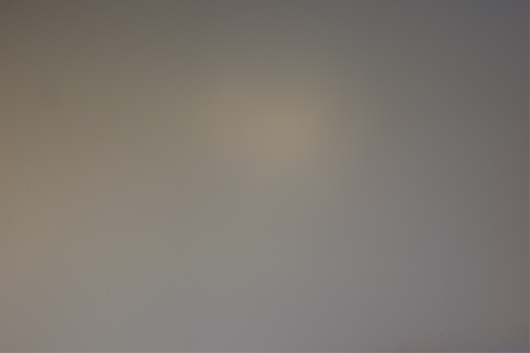

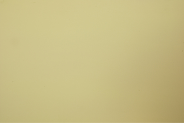

Day 3 - I was not satisfied. That day I used the blower again and tried a very conservative wet swab, using only 1 drop of cleaning liquid instead of the recommended 3.

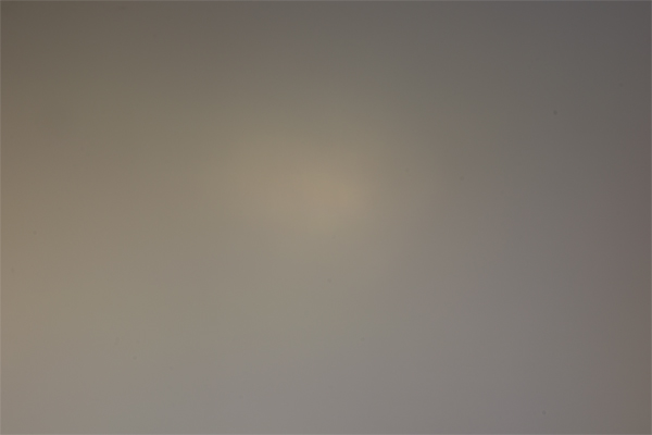

Day 4 (today) - I was very optimistic thinking that this was the last clean and everything would be great. How wrong I was. I used the blower and a wet swab with the recommended 3 drops. I used 3 swabs each with 3 drops. Somehow the end result has brought we almost back to the beginning.
Please help me to resolve this issue. Where did the dust reappear from? Was the swab contaminated? They come in sealed packets and I don't re-use. Please help me to preserve my love of photography and my brain's neurons.

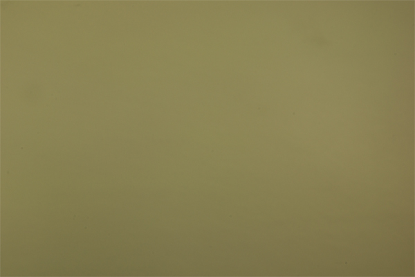

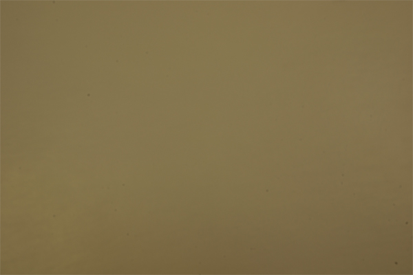

I have cleaned again with just the blower and still there is too much dust. 😞 It seems to be stuck.
Before blower:
After blower:

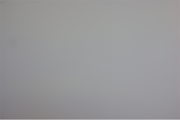

How is your camera now? Do the wipes and buds leave traces? Is there lint left over after cleaning? Please post some before and after shots. I can see from using the blower that, to get better results, I will need to use wet methods, as when viewing the before and after shots many of the dust pieces are in the same place as before. The blower does not move them. The person who's tutorial I was following had much better results than me. He put before and after shots and in the last photo there was almost nothing left on the sensor. I can't understand why I have not had the same success 😞 These are my latest results, far from what is desired.
