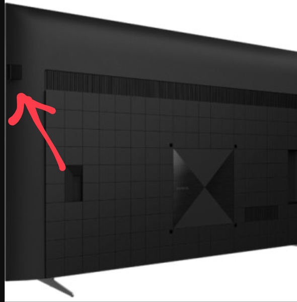

I have a bravia XR65A84K t.v (manufactured on 1/23), the AH3000 soundbar, rear speakers and sub.
I can hear a constant high pitch hissing noise and every time I press a button on the remote there's a clicking noise from the TV. When I unplug the centre speaker cable the sound goes away but obviously I'm not able to use the centre speaker so want it to be on as it's one of the main reasons I brought the t.v( it is recessed so I wanted front facing speakers inside.
After a few months of back and forth Sony sent another company out to replace the motherboard. To start with it seemed fine but I realised the engineer didn't push the s lead in fully so it wasn't on. When I pushed it fully in I'm getting the same problem as before.
