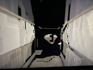

  • Some games, for example Outlast, have graphics artifacts in shadows.

Game Outlast has graphics artifacts:
