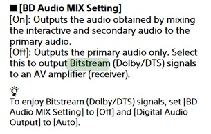

Even though the UHP-X800 can decode DTS:X, unless the soundbar can output DTS:X then it wont play.  In the manual for the UHP-X800 you can output audio via bitstream, but it only mentions Dolby/DTS, with no mention of Dobly Atmos or DTS:X - so I am unsure if this would/could work.
