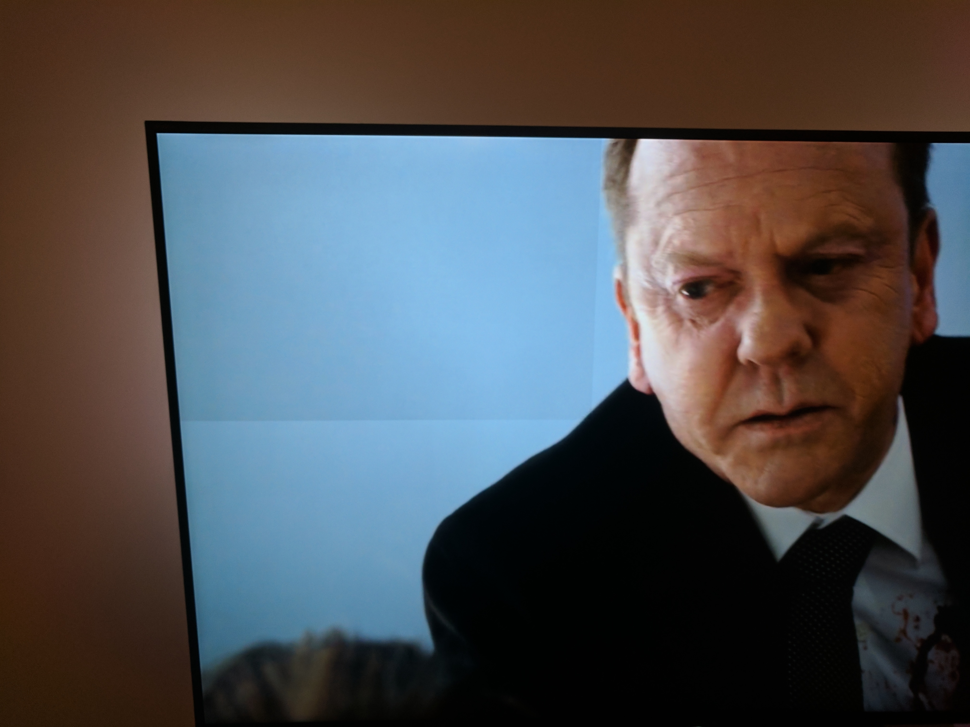

Hi all.
New to the forums so please excuse if I've posted in the wrong thread etc.
Basically, since my TV updated to Marshmallow around 2 weeks ago I've been having an issue with apps running and leaving a faded square box in the top left corner.
Sometimes it's smaller but sometimes can r half the screen.
Happens only on Apps (Netflix, Amazon, Kodi) and not on any HDMi channels.
Seems to happen possibly 80% of the time and I've not found a way for it to stop.
I've reset the TV to factory settings numerous times and also restored with current firmware that i downloaded from the Sony site and flashed using a USB stick.
Also I've ensured that all the apps are up to date via Google Play Store.
Can anyone confirm wether this is a one off in my case or wether the issue is more widespread?
I've attached a few sample images for you guys to see.
Many thanks.undefinedundefinedundefined

Hi all.
I've managed to find a temporary fix for thiz.
Here's a link to a video showing the fix I've been using. https://youtu.be/HYg7a-2FYxU
It is only a temporary fix, switching apps or going back and forth from other inputs will make the squares appear on your screen again but this fixes it for the time being.
I've made the video only viewable via the link as i don't want any trouble regarding copyright on the content i was playing.
I firmly believe after discovering this fix that this is a software issue and not hardware issue.
May be wrong though.

Hi there
So to confirm - the work-around is to go into the settings menu and then out again?
Also, as your YouTube link is clearly demonstrating a problem/solution, there would be no issue in you embedding the link into your post.  Issues only arise when someone is blatently advertising their channel using content that is not their own.
Cheers
Deblob
Thanks for the clarity with regards to the content.
Yes, simply hit the Home key, scroll down to the settings tab and open it.
As soon as you are in the settings main menu, simply head straight back into Netflix (in my case this mostly happens in Netflix) and seems to fix the issue.
