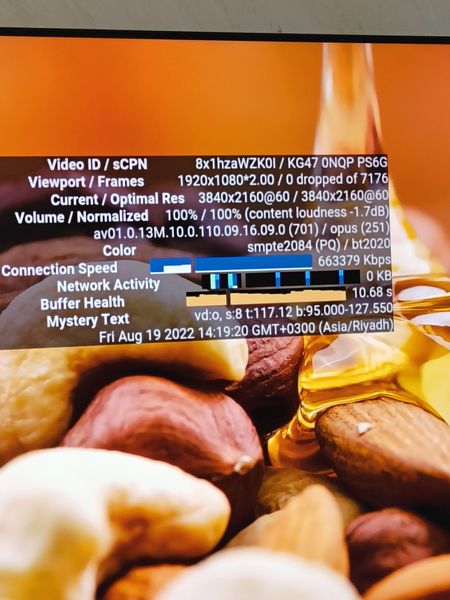

even streaming on YT is faster
my only observation is a high ping of 16 ms while my average on other devices such as mobile is around 3 ms, any comments???
ok figured it out i was using different apps lol
