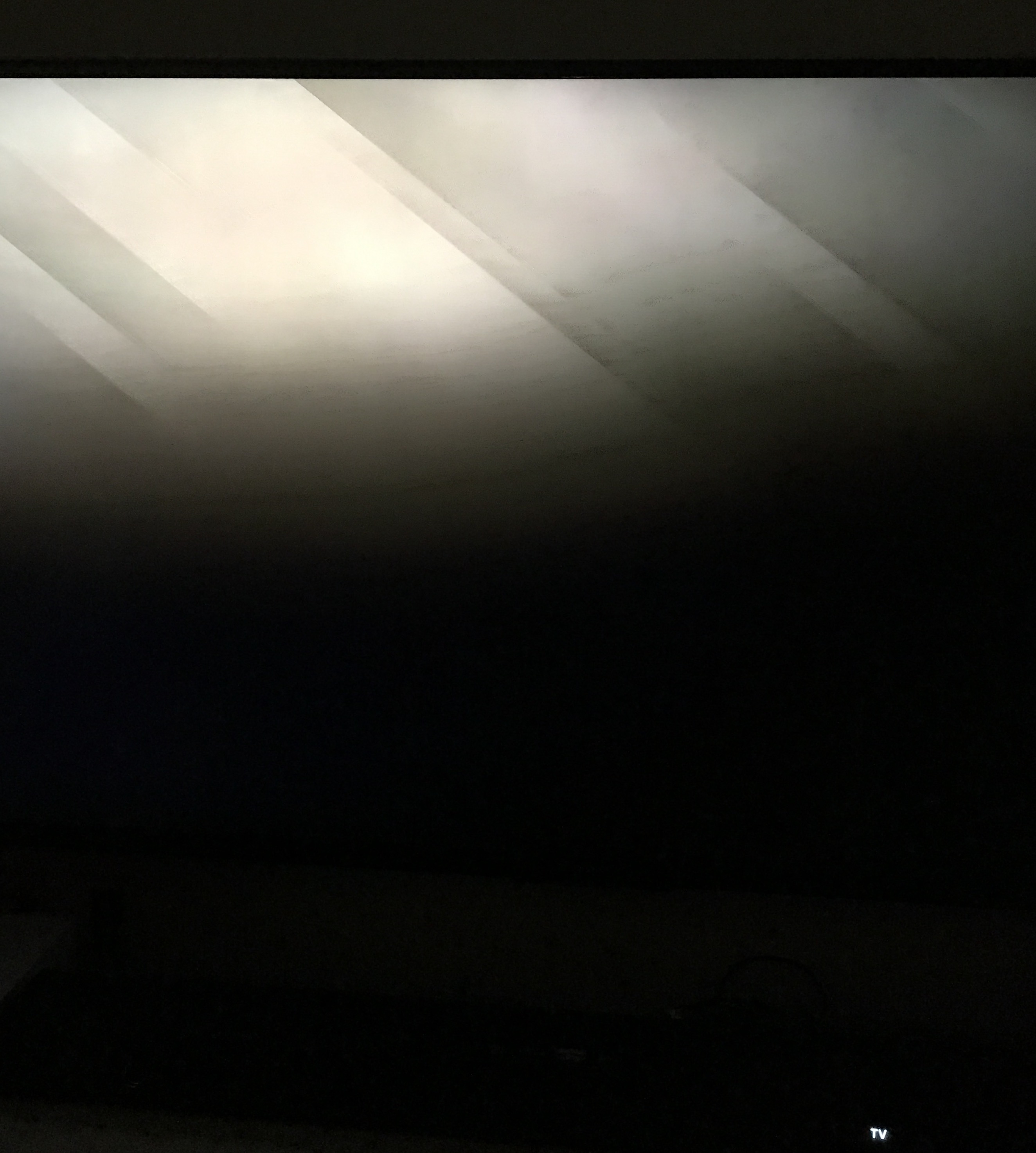

Here's a photo showing the device stuck on TV input with the menu background showing and no menu

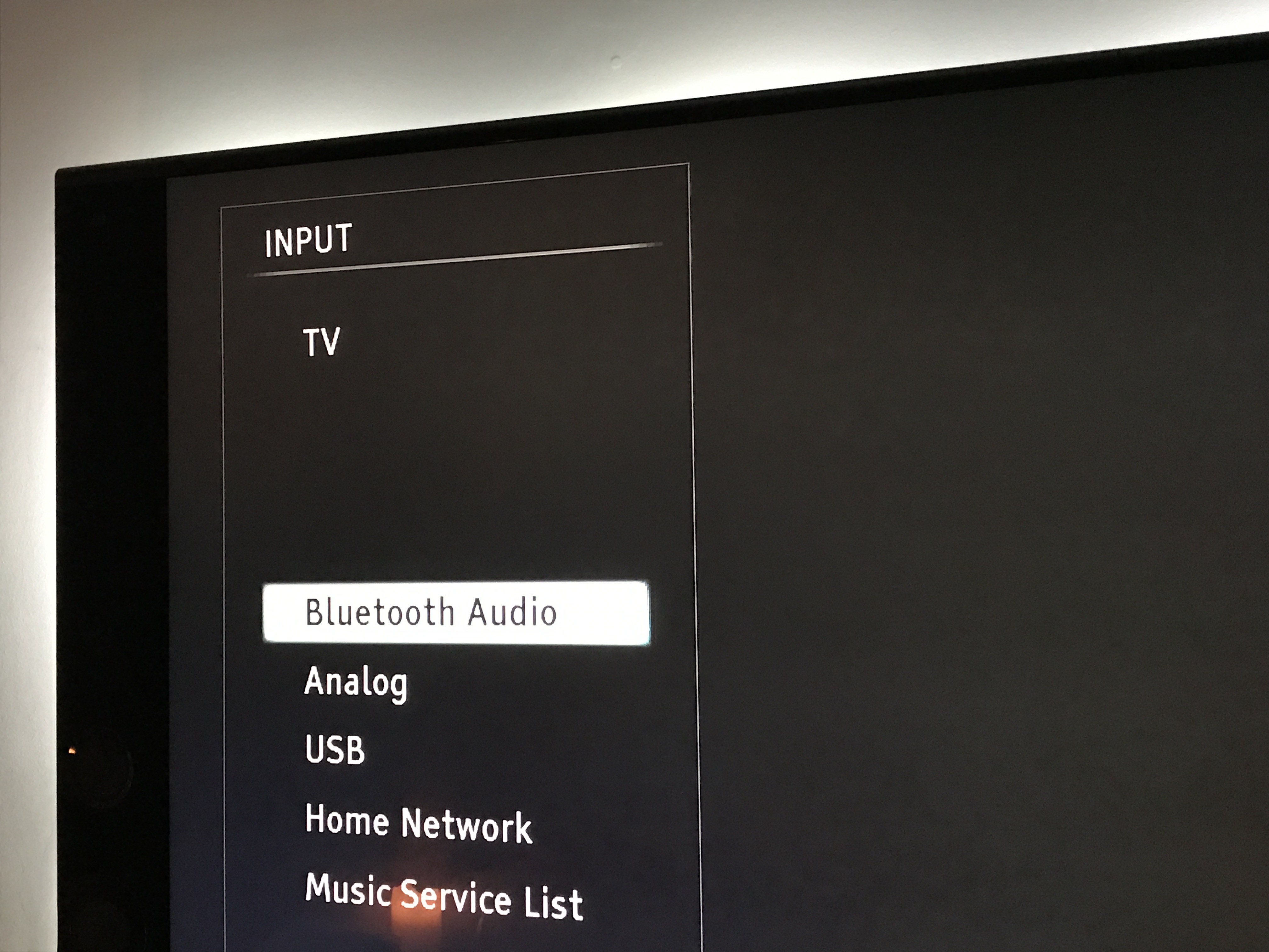

I have attached 2 photos for reference:
1) showing the TV input only display the background graphic of the soundbar menu, the main GUI is inaccessible.
2) when able to access the side input menu (rare and buggy), the HDMI 1, 2 and 3 inputs are blanked out, but can be accessible
